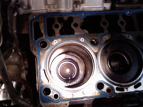

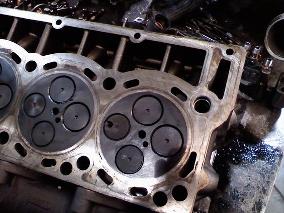

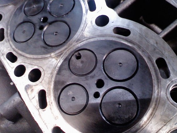

DieselD Posted October 23, 2008 Share Posted October 23, 2008 burned up 6.4 anyone. thought this valve was worthy of a picture. taken from my phone so not the best. nice piston to go with... only 15kmiles. APS boom truck that was "just driving down the road and blew lots of smoke and stalled. will not crank" something was causing an overfuel concern but kinda hard to know with a locked up engine that does not run. willing to bet it was do the very overfilled crankcase packing oil into the CAC Quote Link to comment Share on other sites More sharing options...

GregH Posted October 24, 2008 Share Posted October 24, 2008 Is that #2? If so, there seems to be an awful lot of failures on that cyilnder.. Folks on Ford's message boards talk about #2 lot, and the last engine I had #2 was melted.... Quote Link to comment Share on other sites More sharing options...
DieselD Posted October 24, 2008 Author Share Posted October 24, 2008 yeah it was cylinder 2. i also had signs of meltdown on 1,3,5, and 7. Alot of metal transfer to the head on those holes. my first motor was toast on 2 and 4. we have another truck they has a bent #8 rod from a cooler failure hydrolock Quote Link to comment Share on other sites More sharing options...
snw blue by you Posted October 29, 2008 Share Posted October 29, 2008 What is the cause? Overfuelling ,piston melt and debris launched into the valve head? Why number 2? Quote Link to comment Share on other sites More sharing options...
DieselD Posted October 29, 2008 Author Share Posted October 29, 2008 dont know. hard to tell actual failure when the thing is locked solid. From the looks of the cac cooler being filled with oil and the crankcase being stupid full thats probably the cause. hotline seems to think #2 is the one that gets nailed during an overfilled crankcase problem. talking with the driver he always let the thing run, said it was always regening and only changed the oil per miles not hours. Quote Link to comment Share on other sites More sharing options...
